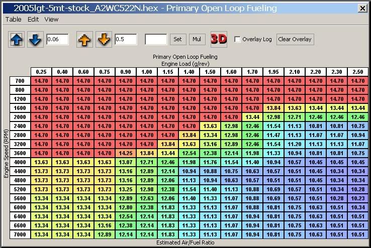

For open loop MAF scaling, it is easier to scale the low-range MAF (60-120 g/s) if the AFR target is lowered in the CL range to something less than 14.7. Here is an example of a simplified AFR target table that can be used to scale the MAF in open loop using a WBO2.
Stock AFR Target:
Simplified AFR Target for scaling MAF in open loop:
