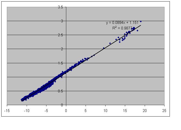

Ok, now I am confused. :roll: I briefly looked at it earlier, and apparently had some bad data points at where the throttle was snapped open.
But, why does the throttle plate not mess this up? Seems like you would have energy loss across it, which would vary significantly with position, and hence VE.
And here is one of my plots - '06 FXT with VF39.

Ok, here are some results.
m         b        IAT    R^2      N
0.0894   1.151     101F   0.9877    2,700
0.093    1.2151     86F   0.9947    3,700
0.0913   1.2041    101F   0.9933    3,460
0.0924   1.2149    82F    0.9637    2,210
M - Slope
b - Intercept
IAT - IAT F
N - Number of data points
R^2 - Closer to 1, better the data fit - Thats all I remember about it.
I may be wrong, but let me think about this...
Load = air in grams / revolution
Manifold Pressure = Pressure in the intake manifold
VE = Load / ManifoldPressure
So basically, volumetric efficiency is higher when we get more air into the cylinder (more load) for a given manifold pressure. Since manifold pressure should tell us how much pressure is actually in the manifold right now, it shouldn't be greatly affected by throttle position. Less manifold pressure or less VE, less air into cylinders - more manifold pressure or more VE, more air into cylinders.
Quick throttle changes would probably affect your data mostly because of poor sampling rate. If you open or close the throttle plate quickly enough your two sample points for load and manifold pressure could be on either side of the throttle plate transition. This would skew those particular data points.
Engine VE is also be dependent on RPM, and I think that is probably a lot of the "width" that I see to the data point graphs.
Also, looking at your graphs & numbers it appears that you are reading load in g/rev rather than 2*g/rev, so in reality your VE (slope) should be twice what they are to convert into 2*g/rev. So more like .18 rather than .09.
