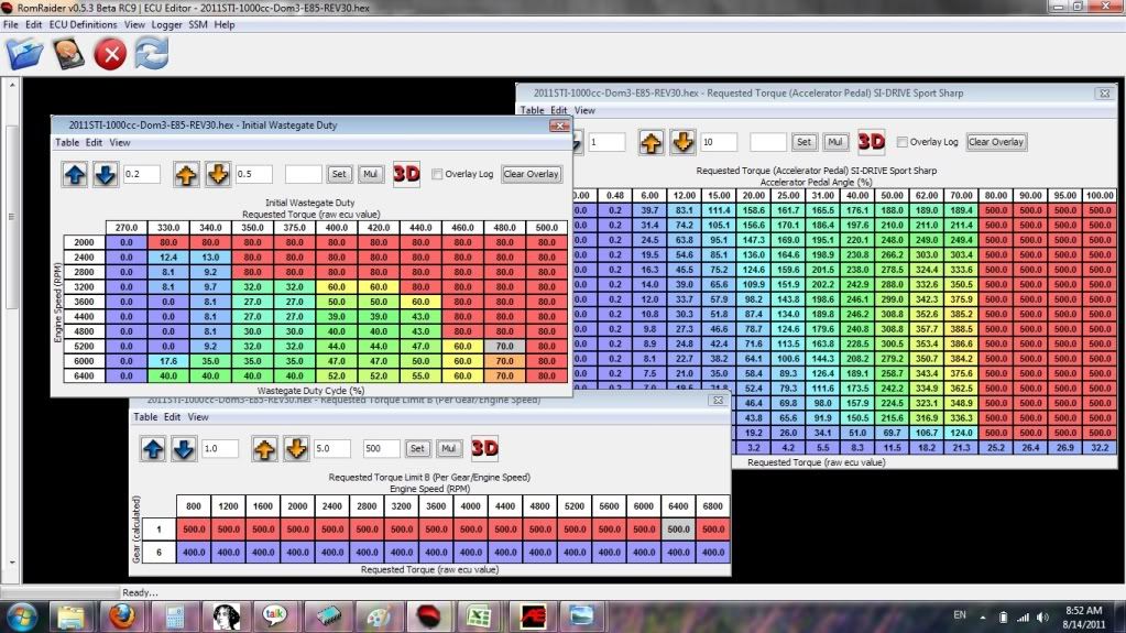

eminehart wrote:
I had a chance tonight to tune a 11 STI and found some interesting data.
I set up the tables 1st gear at 500 and 6th gear at 400
The gears worked out to be this:
1st 500 requested tq
2nd 480 requested tq
3rd 460 requested tq
4th 440 requested tq
5th 420 requested tq
6th 420 requested tq
neutral 400 requested tq
I set up wastegate duty columns for each gear and was able to control boost by gear.
I also confirmed that Requested tq limit a is for sport and requested tq limit b is for sport sharp
I am glad to see you saw the same thing I did. Its odd that 5th and 6th get the same requested torque value, wonder why that is?
What were the mods on this 2011? I see the map name so maybe that's a clue, but I was just curious. I'm still playing around with my WGDC table to hit my target boost.
Also - how to do you tune Sport vs Sport #? Do you go for different boost levels. I was planning to try to hit different boost targets for each mode and I was wondering if this might be tricky if you have the WGDC table setup to take advantage of the per gear torque limit tables.

<table name="Requested Torque Limit A (Per Gear/Engine Speed)" storageaddress="DD754" sizey="2">
<table type="X Axis" storageaddress="DD70C" />
<table type="Y Axis" storageaddress="DD74C" />
<table name="Requested Torque Limit B (Per Gear/Engine Speed)" storageaddress="DD7DC" sizey="2">
<table type="X Axis" storageaddress="DD794" />
<table type="Y Axis" storageaddress="DD7D4" />
STi is only a 2 high Y axis

Martin Donnon wrote:
Edit: put those into the def: AZ1G201G has 500 in every cell anyway......
The idea is not to have 500 in every cell to get per gear control :)
I change the 1 to a 2, leave the 500 in place and then drop the 6th gear torque values to control 4th/5th/6th gear boost targets with the new 2nd gear axis line fine tuning for 2nd and 3rd gear boost control, interpolates everything from 2nd to 6th gear. Finally use the 1st gear compensation to dial in 1st gear target boost etc.

I assume you are thinking along the lines that these tables are for torque limiters... LS1 torque management style?
These two tables are different :) Although that is what I thought it was at first as well haha.
Actual flywheel torque is not affected, however the Target Boost/WGDC is raw torque dependant which is where WGDC can be controlled to stop overboost/underboosting on a per gear basis ;)
Note the WGDC values for requested raw torque. I used 400>425>450>475>500 since it gives me one extra cell
If you manipulate the tables right... you can use SI-Drive as a boost controller and still have per gear control ;)
Edit: This just got me thinking... The A & B tables on a non-STi, are they switched by the Cruise Button? ie Cruise on = A, Cruise Off = B? If so, boost controller under the right thumb would be nice.
