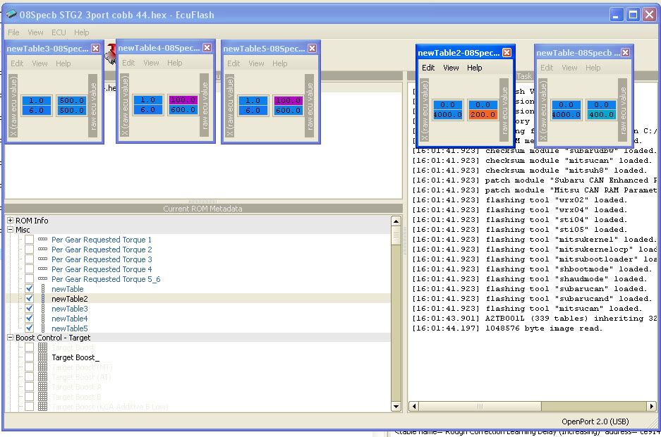

   <table name="newTable" address="c6b74" type="2D" level="1" scaling="rawecuvalue">
      <table name="X" address="c6b6c" type="Y Axis" elements="2" scaling="rawecuvalue"/>
   <table name="newTable2" address="c6b84" type="2D" level="1" scaling="rawecuvalue">
      <table name="X" address="c6b7c" type="Y Axis" elements="2" scaling="rawecuvalue"/>
         <table name="newTable3" address="DBB9C" type="2D" level="1" scaling="rawecuvalue">
      <table name="X" address="DBB94" type="Y Axis" elements="2" scaling="rawecuvalue"/>
         <table name="newTable4" address="C6BC4" type="2D" level="1" scaling="rawecuvalue">
      <table name="X" address="C6BBC" type="Y Axis" elements="2" scaling="rawecuvalue"/>
         <table name="newTable5" address="C6BC4" type="2D" level="1" scaling="rawecuvalue">
And here's what they look like. I would start with the 500 / 500 table.
 Post subject: Re: Per Gear Max Requested Torque for 08+ WRX, 09+ FXT
PostPosted: Thu May 10, 2012 11:19 am
Joined: Thu Nov 20, 2008 9:04 am
Posts: 155
Location: Rochester, NY
Thanks again!
Returned all previous changes to stock and added the 5 new tables. As suggested, I only messed with "newtable3" changing it from 500/500 to 350/300. The result is 350 in 1st, 340 in 2nd, 330 in 3rd, 320 in 4th and 310 in 5th. Exactly what I was trying to accomplish! Thanks so much for the help on this!
PostPosted: Thu May 10, 2012 11:26 am
Joined: Thu May 20, 2010 4:01 am
Posts: 1495
Bingo!
