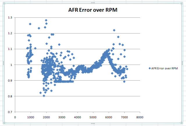

There are parameters you can log to get the target AFR, which will take into account compensations that don't appear in the table. I'm not sure how significant those compensations are, but it's something to consider. "Final Fueling Base" is one, though I don't recall if that's the 16-bit or 32-bit parameter... they're not the same IIRC.
Also, please consider plotting AFR error over RPM in addition to AFR error over MAF. A couple of us have found that some fuel injectors have quirks at certain RPM/Load regions, which will make the AFR/MAF scatter plot really thick, where AFR/RPM stays tight. For example:
That had me really confused for quite a while.

I basically just set the corresponding cells in the fuel table to be extra-rich to compensate for where the AFR was getting lean. And you could also say that I set the MAF curve so that the injector quirk only caused the mixture to be leaner than target, rather than richer. So I ended up with the AFR that I want, but the fuel table had 'holes' dug into it here and there.
In Excel I had a column that was "=max(Primary Open Loop Fueling, 11.2)" where 11.2 is the AFR that I really wanted. Then I computed AFR error based on that column rather than the AFR target from the ECU. (At the time I was logging "Primary Open Loop Fueling" but if I remember correctly, merchgod added support for the Final Fueling Base parameter some time later.)
It might be useful to allow people to specify a "minimum target AFR" so they can enrich certain regions of the fuel table to try to work around this issue. But on the other hand, it's probably better to just encourage people to throw out (or send back) injectors that do this. I always wondered if they were leaning out evenly or just in one or two cylinders. After switching to better injectors (ID 1000s) I get a lot less non-repeatable knock events - it used to be that if I saw knock in one log, I'd do a couple more pulls to confirm, and often it wouldn't recur. With -5 degrees of timing I'd still see knock events in pulls. With the new injectors I don't see knock until I am actually close to the knock threshold. So I think the old injectors just kinda sucked.

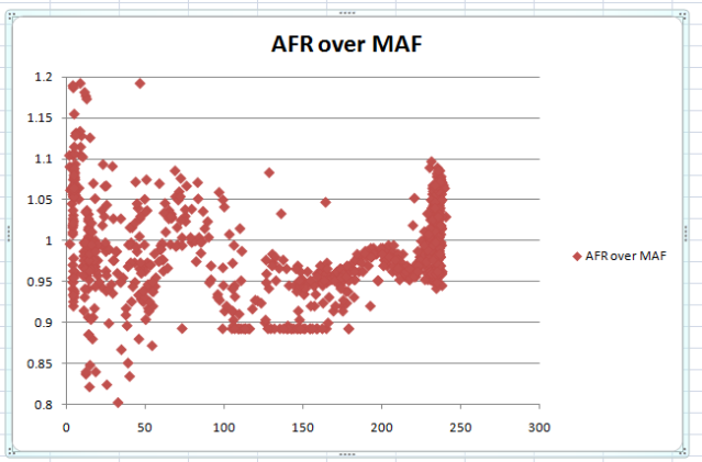

Also, thinking ahead here.. are the numbers in your graphs above in % or actual AFR error?
Need a sanity check here. Since we're dealing with error now and not actual correction (thinking about OL MAF, not the OL Fuel tab), the correction applied shouldn't be the same as the error. For example, if your target is 12:1 and you're hitting 13:1
12:1 = 8.33% fuel
13:1 = 7.7% fuel
Rather than the correction being 12 / 13 (7.7%), it should be 8.33 / 7.7 (8.3%)

The current closed loop MAF scaling tool works fine, but after using that to get into the ballpark I felt like I was able to get better results faster by forcing the ECU to used open-loop all the time, and then using open loop techniques to scale the whole range.
You have a good point about needing a separate table for true AFR targets. In my case, I was using a fuel table with a large region of 11.2 cells (almost everything about ~2.0 load IIRC), and the MAF scatter was pretty tight until I got into that region. So I could come up with a useful target AFR using "target = max(11.2, target)" but in retrospect, I just got lucky that it was that simple.
A general solution would require a "true AFR target" table somewhere... which honestly probably isn't worth the trouble. The more I think about this the more I think crappy injectors should just be replaced. :) Plotting AFR error over both MAF and RPM will help identify crappy injectors though, so I still think that part would be helpful.
The Y axis in the plots above is (actual / target), so it'll be 1.1 where I was 10% lean. So, if actual AFR is 13:1 and target is 12:1 I'd call that 13/12 = 8.3% lean. Same number you came up with, just less math to get there. :) If the tool is going to make MAF scaling corrections automatically then I'd suggest cutting the percentage in half, e.g. make a 4.15% adjustment.

I think the open-loop MAF scaling feature should plot AFR over MAF, and use AFR over MAF to make corrections to the MAF scaling.
However it should also plot AFR over RPM, so that if someone has crap injectors like the ones I had, the plots will make the problem easier to see. It doesn't need to actually use that data for anything though. If anyone gets a wide scatter in the AFR/MAF plot and a narrow scatter in AFR/RPM, they will need to either swap injectors or use other tools to tune fueling (e.g. Excel).
It's not just me, by the way. LittleBlueGT saw the same anomaly with a different make-and-model of injector. He was smarter about it though - he sent them back. :)
